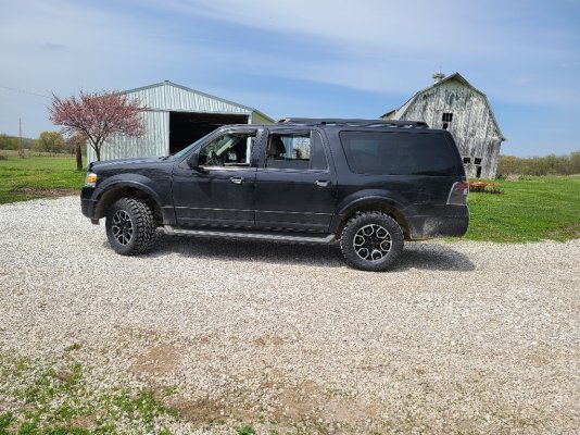

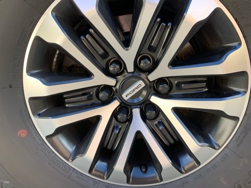

I put the Gorilla nuts (NOT an actual gorilla's...erm, ummm...yeah..you know what I mean) on my '11 when I put on the '21 FWonFiddy wheels. These lug nuts are great, better than the problematic stock ones, and look good as hell, black on black wheels.
I do wish I'd gotten the 1.5" instead of the 2" now, but I'm also considering a 1/4" spacer so I'll have to run longer studs if I do. We'll see.
My combo fills the wells out nicely, but I think it would look a little better with a slightly wider track width.
Anywho, I recommend the Gorilla stuff...here's what I have:
https://www.amazon.com/gp/product/B00ZSDHHN2/ref=ppx_yo_dt_b_asin_title_o00_s00?ie=UTF8&psc=1
Here's a shot of my newly installed wheels/tires and the Gorilla stuff holding them on
