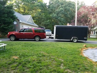

I have a 2017 EL limited with the heavy duty tow package. Today was the first day we towed anything,we went to NC 230 miles away. We towed a 15ft enclosed trailer with 2 ATVs. I filled up when we left- I get here and I have 2 gallons left. WTF! I got 7 MPG. Is this normal?

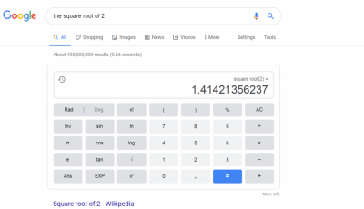

Once rolling the major (certainly not only) influence of fuel use is air resistance which is exponential meaning as speed doubles the resistance increases by a factor of 4. And a speed increase of about 40% will double the air resistance (1.4 is the square root of 2). Takes the same amount of power to move the vehicle thru the air regardless of what engine or fuel is used. Air resistance at 70mph is roughly twice what was at 50. Slow down or burn fuel -- it's that simple.

We traveled around 65-70mph on i-95 so not rough terrain. I would imagine towing a travel trailer would warrant this MPG but it's just an enclosed trailer with atv's, maybe 4k tops. We just connected the trailer, is there a setting on the dash display that we should've changed to tow? I filled up with 87 octane.

It's a 2017 expedition EL limited ,eco boost, 4WD, power running boards with navigation and HD tow package. I usually average 19mpg with day to day driving.
