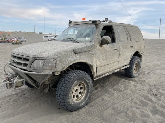

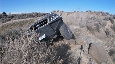

Little flex test.. back to open front diff, and had a good time out playing.. got some video but it turned out mostly crap because I forgot to wash the window, lol.. Next in the list, without question, new transmission mount. That thing hangs nearly 6 inches below the frame. Got hung up 2 times yesterday on it. I got a pretty good plan to remedy that, but first a couple medical issues to take care of.. The rock bars did very well and held up nicely, supporting the vehicle weight even a couple time. Overall I was pleased. Also, the drivers side cv shaft is 2 separate shafts, cut in half and the good ends welded back together. An ‘I really need to test’ repair!! I expectedcb6c50b7e94c4c5cda76c928652bf59b.jpg
to snap it in quick fashion but it held the entire day. Will have a new one coming soon. acf1f402d47b8d37558d93d01b5f2135.jpg

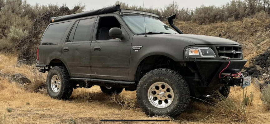

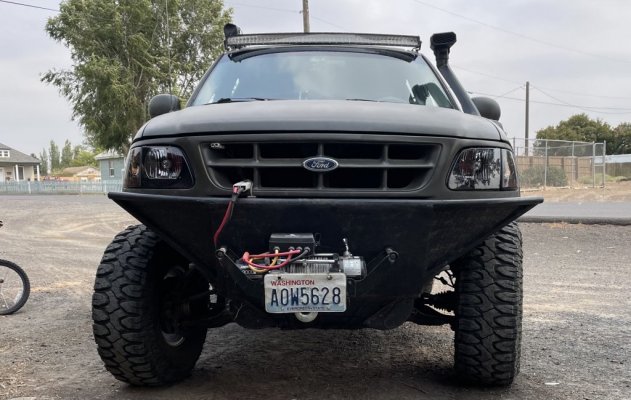

Was hoping the OD green would help hide the roughness, but it just made it more visible. Gotta love a good dent with a good story tho, and this girl has lots!!
