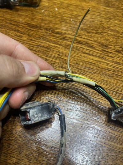

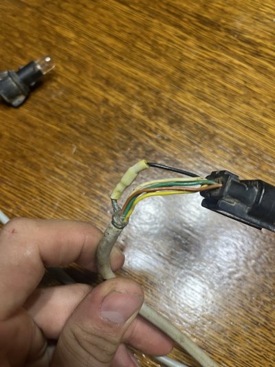

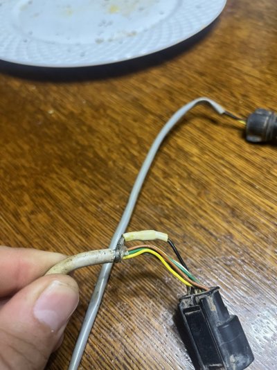

So Sunday I went back at this again - when I got to the wiring harness - all the connectors still looked good and tight. There was dirt in the area but nothing inside the connectors etc... Dielectric grease still good and the rubber grommet in great shape. Took the wiring harness out of the car to examine it more closely. This is a couple of wiring harnesses actually - one for the license plate lights, the window actuator and then the rear camera. They all terminate on the same connector located inside the rear liftgate inside it where it plugs into the larger harness that routes around the rear window and into the ceiling. The part that's outside the vehicle beneath the "expedition" trim piece is where I focused. I unwrapped all the electrical tape and saw that someone else had done work on this harness. Looked like they cut and crimped the black ground wire into the shielding directly where it plugs into the camera - then about halfway down they cut the sheathing away to see the shielding...then at the other end they crimped the black ground wire into the sheathing on that end inside the car. There was some other crimps for other wires. I ignored them. I decided to cut the black wire to the shielding on both ends and run my own black wire through and crimped them to each end prior to the connectors. I then taped everything up nice and tight, added a dab more dielectric grease and put it back together. Worked great!!

I know it’s been a long time. How is your camera?
I wanted to reach out and tell you that I am thinking your wiring harness is OEM.
I recently made a post asking if my wiring harness looks worked on… but it’s exactly as you described. This tells me it must just how they decided to wire this harness.
