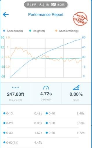

My wife’s 2020 4x4 Max SE on stock 22’s on an E85 tune. Nothing else done. Just ZFG tune and E85 in the tank.
