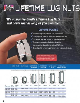

Has anyone found a solid American-made lug nut that doesn't rust to sh*t in three months? The Gorilla ones rusted in no time here.
I installed Gorilla solid steel chrome plated on my 2014EL last year. Yes, there is some surface rust but to me its still preferable to the OEM cap (or shall I say crap).
I see that Gorilla has (on their website https://www.gorilla-auto.com/) a line of solid chrome plated nuts that they call LIFETIME, guaranteed not to rust. I guess I bought the other ones under LUG NUTS and they are rusting a bit. There are different part numbers and the LIFETIME ones have GORILLA stamped into them so I know I don't have them. Seems like they are about the same price. Its a jungle out there, confusing.
I see they also offer nuts that are heat treated. I thought they all were heat treated so I don't know what that buys you or if I should have gotten those. Its too confusing for my undersized brain. But I guess if I was doing it again I'd buy the 60 degree M14 by whatever length my Expy is solid chrome LIFETIME acorn nuts.

Heat treating relieves stress in the material induced during manufacturing, and improves strength and/or ductility. There are two types of heat treating, annealing and tempering.
In a nutshell, annealing heats the metal and then allows it to cool slowly. Tempering is heating metal and then quenching it (douching it in water). Lug nuts are tempered for hardness (you don't want a soft lug nut)

So according to a few pages earlier in this thread,, 2014 and earlier is 14mm x2.0, and 2015-17 is 14mm x1.5, so if I follow that chart, is everything in the row beyond those two specifications just personal preference, or is there more to it?

I think so, but standard lug wrench is 13/16" so you would want that, right?
Unless you want to carry a special wrench.
That chart actually confuses me. There's a cell with 12MMx1.75 but the dimension at the top is 1.4" not 1.75" and that I do not understand.
What I did to double check was pull one off and measure it first before ordering.
