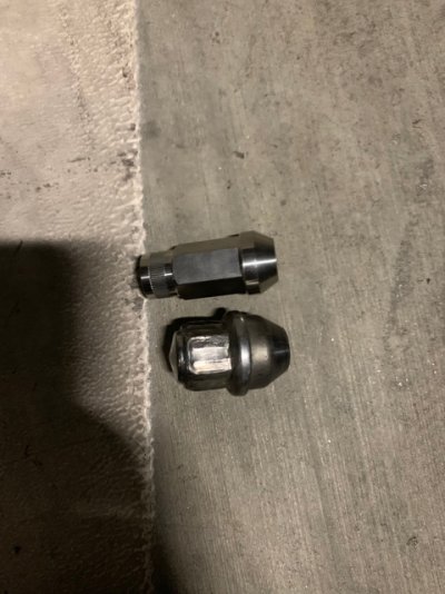

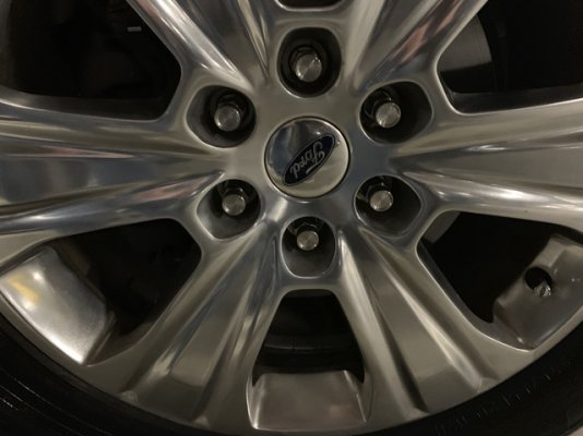

I ordered some off Ebay for $40 and installed them today all went smoothly! Just make note for 2015 models and newer you need M14X1.5 60* cone.
The single piece steel construction is sooo much better then the crappy Ford ones had 5 of them I literally had to hammer a socket on to get off!
They came from CTM Auto Parts
