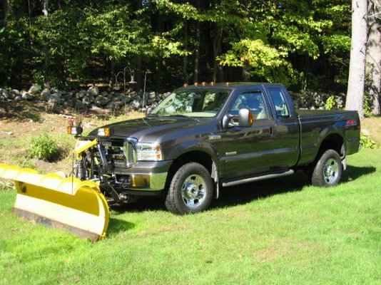

How is it working out for you? Solid? The price is right for sure. I did the same thing on my 05 F350 diesel. 8' Fisher plow for 100k miles of Mass winters and never missed a beat.

I love you guys... "Good luck down the road...spacer snaps apart." Doom and gloom lol Like I mentioned above. Inexpensive spacers sat under my 05 F350 6.0 diesel for 100k miles of plowing in Mass over six years. I think if it would have broken, I'd have been the one to break it. More expensive doesn't mean better or that there is anything wrong with the less expensive one. I tend to choose common sense over throwing money at something.
