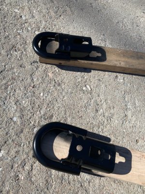

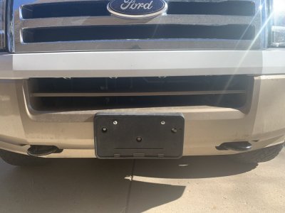

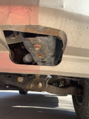

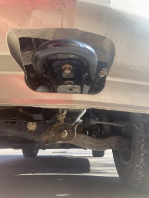

When I bought my Expedition, it didn’t have tow hooks. It looked as though it had a grill guard and the tow hooks got removed when that was installed. Some gates in oil fields have latches that are actuated by hitting it with your truck.
While at the local junkyard getting some parts to sell my 1st gen, I came across a wrecked EL that had it’s tow hooks. I grabbed them and hit them with some black Duplicolor Ceramic Brake Caliper paint. The ceramic paint seems to be a little more durable than regular paint.
Simple “upgrade”.

Nice to have when you get towed out of a ditch etc. Good find.

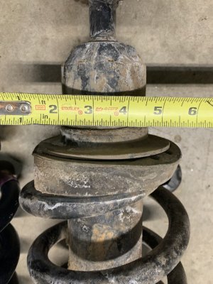

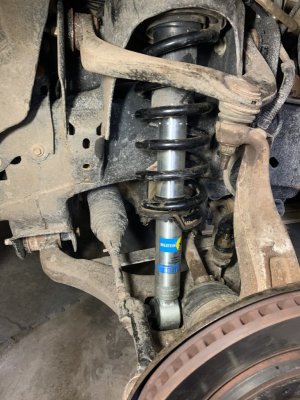

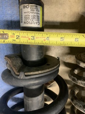

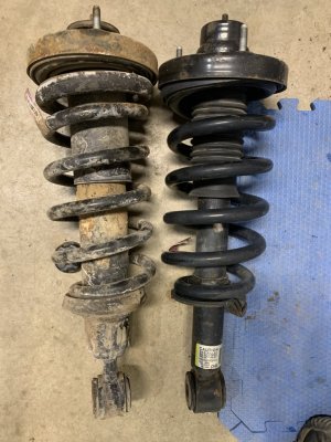

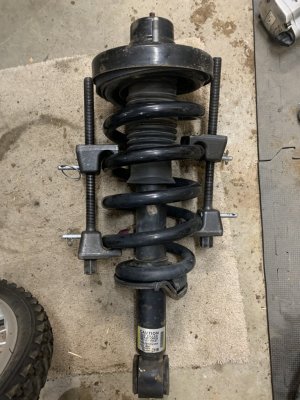

I knew my shocks were original and noticed some clunks and bumps going over bumps in the road. The right rear seemed especially bad.
I decided to go with a full set of the Bilstein 5100 height adjustable shocks.
Installation was...... involved. It’s mostly just what I call a “nut and bolt” type installation- one where you just need to remove a bunch of nuts and bolts. Of course there is the added fun of the spring compressors, but I’ve swapped plenty of springs before.

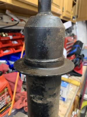

The issue came in the rear. Part of the install is to swap over the lower spring seat. I removed the coilover and got the spring off. I started pounding away at the lower seat but it’s not budging. It was pretty dirty and there is some rust on components here and there so I thought maybe it was just rust holding it on. After a closer look, it looked as though the lower seat was welded on. Crap! An even closer look revealed that the shock I pulled out was fatter than the Bilstein slated to go in. Even if I got the seat off, it wouldn’t fit.
I put all my hopes on that mine had some kind of unique suspension and something at the junkyard would work. So off to the junkyard I went. I found a 2010 with the skinny rear shocks. I pulled those out pretty quickly and easily. All I really needed was the lower spring seat, spring and upper mount, but I bought the 2 complete assemblies. For $35 I can’t complain too much.
However, the 2010 springs are thicker in diameter than my 2014 springs- which probably means they also have a higher spring rate.
The rest of the install went fine. The right rear was totally blown and leaking fluid. One of the front had good compression control but had a really quick rebound.
I set all the clips on the Bilsteins to their highest position. I think the 2010 springs caused the rear to set a little high.
Resulting ride is MUCH improved. Feels like a truck- but in a good way. 606B8081-1C8B-4F8E-97EA-78CC823C212B.jpegFCFE6E0E-F4F8-4A4C-A598-40E8B29DB9BD.jpegB52491C4-6E12-4638-834A-20E8B62C36A3.jpeg4AF71005-75B0-4214-88DF-1E6D1AB17E1C.jpeg
