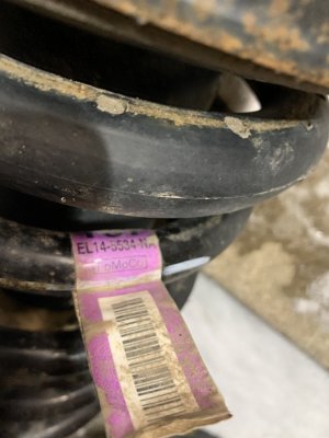

Sounds like a better idea but many people are buying the spring with it so they can just throw it in.
It would certainly make it faster since you aren’t needing to mess with a spring compressor. A lot of people are wary of those things.
The compressor doesn't scare me but you take a chance of the spring not being the same and it costs more money.

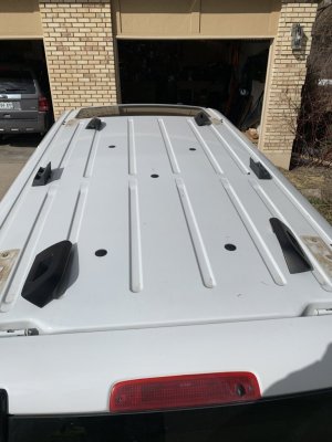

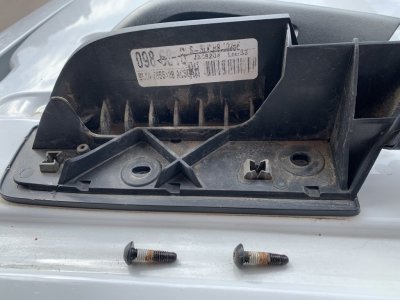

I’ve had this Eezi-Awn platform rack for several years now. This is actually the 3rd vehicle it’s been installed on.
The factory rack came off pretty easily. I noticed an odd “ring” around the factory feet. I’ve also noticed a similar discoloration on the lower part of the tailgate. I think I’ll try some claybar on it and see what happens.
Wind noise has increased. It’s not horrible, but noticeable.
