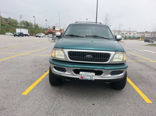

My expy appears to looked lifted. I cannot find any OEM or aftermarket identifications on any of the suspension parts but there were "trail master" stickers on the window when I bought the truck.
It looks like its lifted ... How can I be sure?

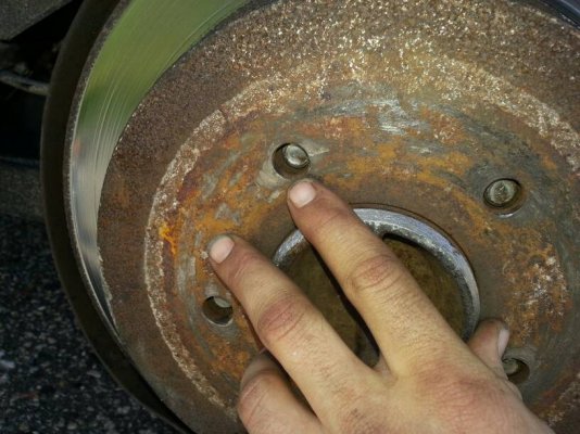

The first is the damn driver side rear wheel snapped off the studs as I was driving on the highway. Like wtf!!?? It was fun towing it, then replacing the pressed studs.. I had to make the hole bigger at the drum-in-hat backing plate where the parking brake star wheel adjuster is in order to fit each stud in the hub. I really don't have access to the tools to pull axles.

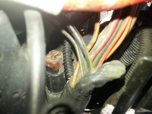

Then I found it.. One of the noise suppressing capacitors was touching the exhaust pipe that has the dpfe hoses coming from.. It welded itself on there due to it shorting out. So I isolated and replaced the fuse and a day later she fired right up. Never hated this truck so much before that. I'm just lucky I could fix it between classed and with no tools basically...

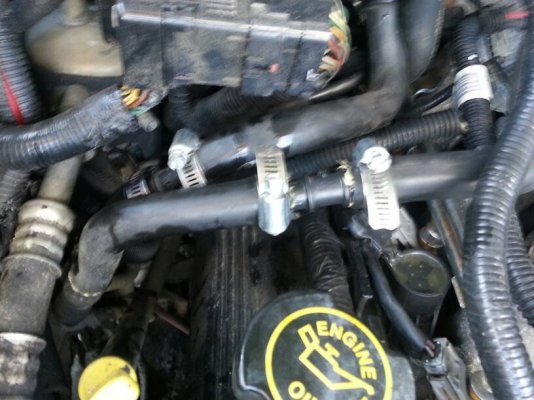

I also replaced the heater core ... I found the hoses that led from the coolant under the hood were cut and isolated from the cores.. By the time I'm done with this truck... It'll be brand new again!!

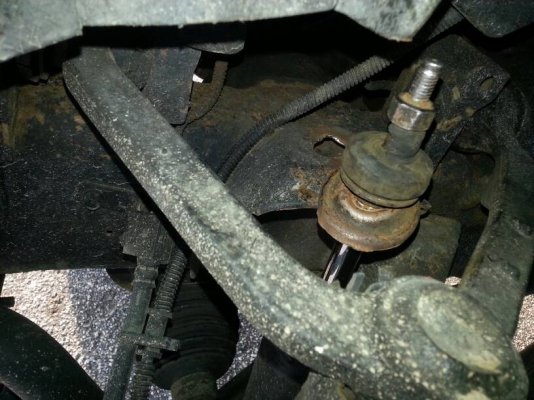

Today, the driver side strut came out and broke the tower it was mounted on (on the upper control arm).. FML....
