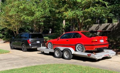

42CB5749-8A8D-4042-B26D-80B20AC71C65.jpeg I’m getting a vibration through the chassis at highway speeds when pulling my open car trailer with my ‘19 Limited RWD. It feels like a rear wheel out of balance, but there’s no trace of it without the trailer. I’m at about 550# tongue load, but it doesn’t seem to be sagging enough to cause the driveline to be excessively out of line. Anybody else run across this?

It was much better the last time I towed, but not completely gone. I think the new tires on the trailer helped, as did shifting weight off the tongue. I was close to 600# initially, and moved my car back on the trailer to reduce it to about 500. My trailer is too low to use with a weight distributing hitch, and it shouldn't be necessary with a total weight of about 5000#.

Bringing this one back again. New car on new trailer, new tires. Vibration at 55-60 was bad enough to wear my neck out after a 2-hour drive. I could look over and see the passenger seat shaking. Didn't seem to matter whether or not it was under load or not, just that speed range. At 65-70 it was smooth. Doesn’t seem to matter what gear it is in, either. Seems like a higher frequency than wheel speed on the Expedition, but it sure feels like a wheel balance issue. Except...it goes away without the trailer attached.

Sounds like one of the trailer wheels needs to be balanced. It’s a new trailer with new tires but those throws were on it when you bought it or you had them mounted and balanced and put on it?

I did balance the tires on my old trailer. I just checked the wheels on the new trailer and didn’t see any weights, so I have another project for this week.
I had vibration at 35-45 with the trailer empty. With a 4000# car on it, the range was 55-65 mph.

Balanced the tires yesterday. Max weight added was only 1.25 oz. so I don’t think that would cause it. We will see.
