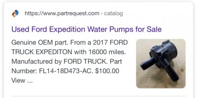

This is what it looks like and has the same part number on top of it. What is this?

What you hear is passive siphon cooling after you shut it off, in short coolant is still flowing for a while. Turbo engines do that so the turbos don’t cook the oil after you turn it off. After coolant stops pumping it heat soaks and heats up even further. If coolant didn’t continue to flow the turbos would cook your engine oil badly over a short period. Having air in the system you are likely hearing this more so when it occurs.
