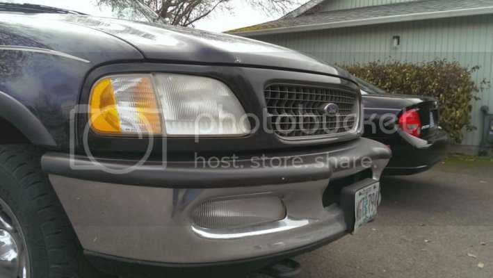

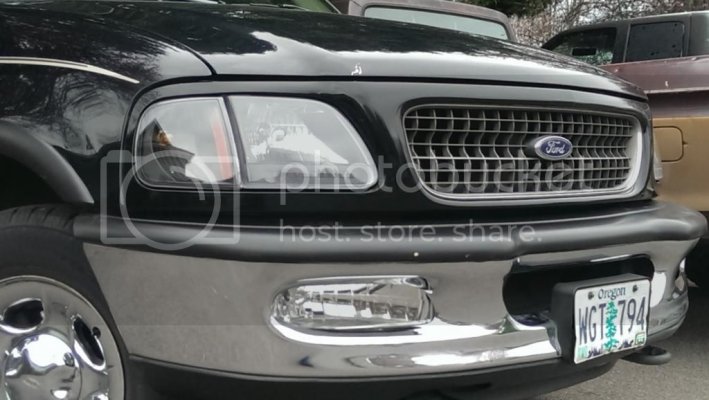

Finally ordered some headlight lenses. I got the lightning style lenses and plan to save up to buy this later in the year.
I need to replace the top brake light soon and also plan to replace the brake and turn signal lights with LED lights. the instant on/instant off is safer as it's easily noticed in ones peripheral vision.

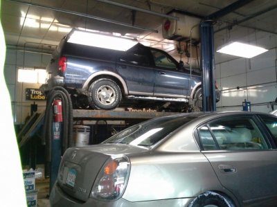

finally got the front tires replaced. the ones that were up there were from 2006 it turns out. they were bald and dry rotted badly I estimate they had at least 70k miles on them...
This pretty much closes out the major maintenance on my expy except for the front end suspension refresh which I may or may not order this week. I'm going to begin to work on cosmetics soon starting with the front end. I need new fenders and the bumper is pushed in slightly. I'm not sure if I want to de chrome her or leave everything in a factory state.

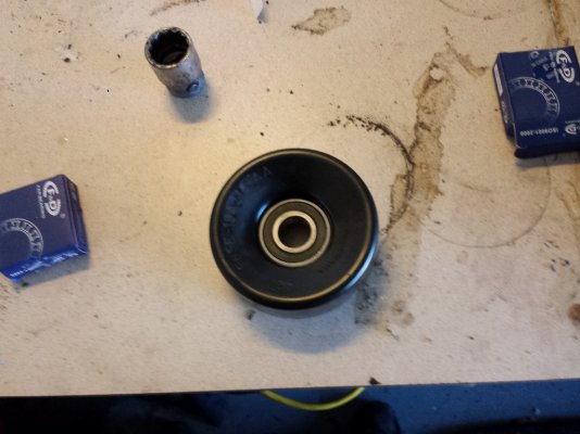

Been having the CEL come on so I worked on that today. Hopefully I got that figured out. Put a new belt on while I was under there. She is purring like a kitten again....
