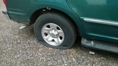

Woke up to this today. some idiot went out of his way to clip a pallet in the side off the road, the two cars in front of me scattered the remaining debris around. i ran over all of it :( three wood punctures and the tire was deemed "not repairable" and replaced free under the roadhazard warranty. i only had to pay $13 for a new warranty on the new tire and was on my way.

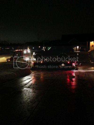

Got it towed to the dealer!! :frown:
Coming to a stop light, it just died. It's done it before, but always started right up. In the past it's been an open circuit in the TPS, so I assume that's what it is, but I'm not going to throw money at it until I know for sure what it is. I guess I'll find out tomorrow. Luckily a neighbor was driving by and towed us back to our house to wait in comfort for the tow truck.
Bummer deal man!
