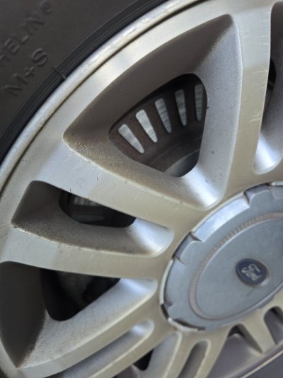

So, grinding noise from the back, then I see... THIS.
What/huh/what, how does that even happen?
Which kit should I get to replace it, Detroit Axle or Powerstop? Or is a 3rd reasonably priced alternative preferred? Thx.

How does the rotor on the other side look? If it is not wearing evenly, maybe check the calipers, pins, and brake hoses.
It looks intact.
Couple scratches and some rust, but it's ROUND and it's, like, ALL THERE.

Looks like your caliper got stuck or the pads disintegrated and it ate through the whole front rotor surface into the cooling veins. You should probably replace both calipers when doing the rotors and pads. One of those good preventative maintenance things. Don't cheap on brakes, it's the one thing keeping you safe when it matters most. For me it's my wife and 4 kids, and I need to know when I'm not there, that she can stop the beast on a dime. Hope everything works out!
