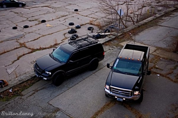

It's definitely solid enough to stand on or completely overload with things but it isn't solid "flat" it has the crossbars all around it.
See pic.

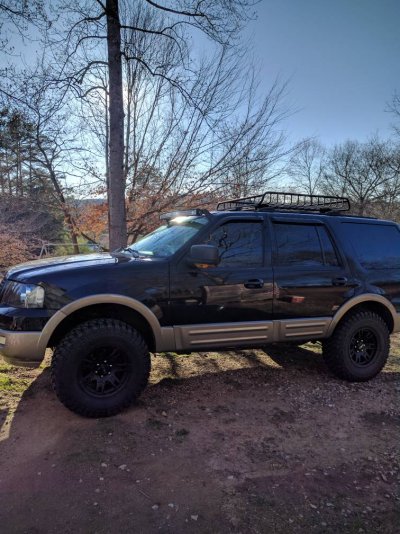

@ Grunz7 I got my Yakima Load Warrior basket rack. Now I gotta order the 18 inche extension to make it a full rack.
I had to slide the rear crossbar forward to mount it but its temporary.
The wind fascia is off BC I painted it Matte Black and had to order a New Yakima Decal BC It had to come off for paint..

Hey scoot how did you mount that light bar up top? Did you fabricate brackets? Your ride looks sweet brother!!

I ordered the door jam mounts off eBay for a 04 F150 was like $40.
Then I had to fab them up to fit my 03 Expedition door jam..
The provided screw's would not hold so I got 6 2" long 1/4" bolts with nuts and drilled all the way through the A pillar's and tightened the nuts up then reinstalled the A pillar trim.
But I used Black Marine sealant . I put a 1/4" bead around each hole I drilled then put the mount on and covered the bolt head's .
And so far no water leaks.
If u wanna go this route lmk and I'll post some pic's how I did it to give u a visual of what's involved..

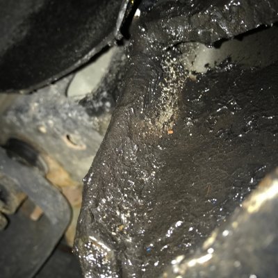

This is he best I got saved on my phone... that is behind the drivers side wheel against the firewall, you'll have to trim the fender liner like I did, and then there will be a big pinch weld sticking out, as you can see I banged that in with a mallet against the firewall and then hit it with undercoat...
let me know if you need better pics I can get some tomorrow.... my truck doesn't run right now lol

Yea sorry to hear about the transmission brother hope u get'er back up .
This pinch weld was the tire's rubbing it or did u bend it over for (Just n case )
I'm going outside now n take a look at mine..
