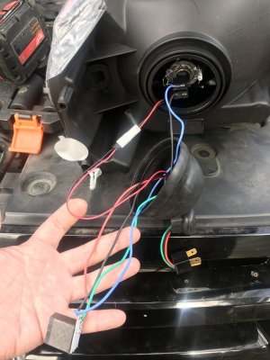

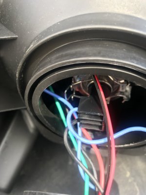

Need some help with some headlamps i just bought on OfferUp, the main plug appears to be maybe a relay or at least that kind of plug. maybe it plugs into a relay? idk im not knowledgeable with electrical however I follow directions well.

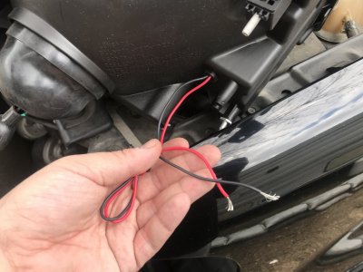

also it has two raw wires, sort of looks like they come from the DRL but it's hard to tell; this would also be odd as there's a bunch of wires on the inside of the sealant cup that holds the light bulb.

What year is your Expy? Were your original headlights halogen, LED or sealed???
What brand are the ones you got on offer up? and what type are they LED, halogen???

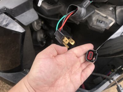

The connector with 3 wide spade blades probably has 1 ground, 1 low beam and 1 high beam.
as far as the red and black wires, they may be parking lights but without more info it's hard to guess

That plug is what would be found on an old school 1990s sealed beam headlight . Weird...

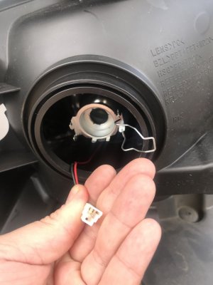

I got it sorted out, at first it didn't seem like all that wiring would pull out but it does, and what appears to be the case is that they give you two options:
DRL has a custom plug inside integrated into the bulb wiring for the halogen H7, meaning would just need a H13 adapter to that big plug which is an H4.
option two which is my option since I have HID's on the way ( H7 ), you use the HIDs own wiring which will still need an adapter from H7 to H13 which i just ordered. then, you use the two raw wires to wire up the DRL from another source such as the side marker stock plug or turn signal.
in a nut shell it's all sorted just need to wait for parts to come in to put it all together.

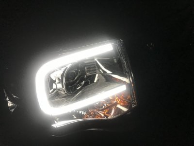

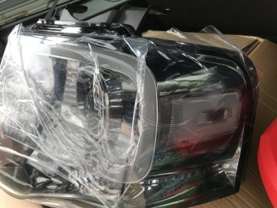

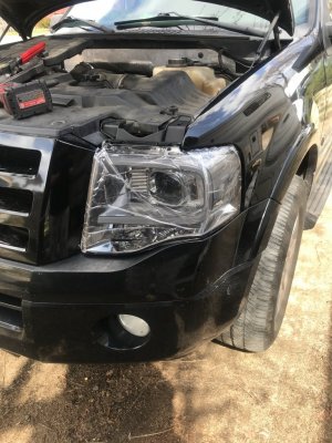

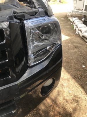

looks a bit wonky with the plastic wrap still on it but I'm waiting until i'm done moving them / installed.
they were 250$ locally picked up in case someone is wondering, there were a few sellers in my area around same price.

If the projector is a bi zenon and there isn’t a separate high beam lamp, those other wires might be to activate the solenoid on the high beam shroud inside the projector. That’s how the Morimoto ones I have work. They came with an external control module that everything plugs into. If those wires are the DRL then there has to be some control for low and high if they were made for HID. I can’t tell from the pics but I’m guessing a controller is built in somewhere.

That old style plug is still used by some companies like Nissan. My parents have a 2015 Versa and I put a TheRetrofitSource.com Morimoto kit on theirs because the factory lighting was unexceptable for anyone let alone an 87 year old.

Ok, I see now. I didn’t notice two sets of black & red wires. The ones inside the housing with white connector look to be the high beam shroud. The ones with no connector probably are the DRL.
that would be interesting if the white connector one is high beam, i was figuring two different wiring options on the DRL. i'm waiting on my adapter to come in mail today, it's already night time but says it's out for delivery.

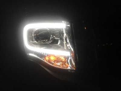

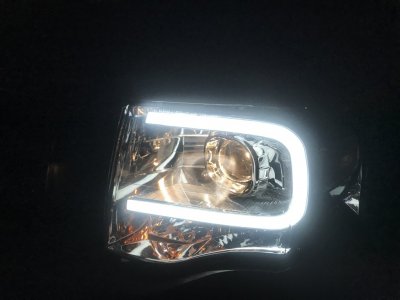

adapter plug came and the rain stopped. headlights are installed, using halogen bulb for now until HIDs come in a few days up to a week. i'll also be throwing on HIDs to the fog lights, anyone have experience with that? I want to make sure these fog lights won't melt lol ( 35w but still ).
I can take day pics if anyone is interested.

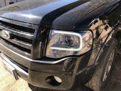

Kjhawkeye1
Aug 2, 2017
185
84
River Falls, WI
Andy Rubalcaba
Andy Rubalcaba
Mar 6, 2021
136
48
Riverside, CA
I looked at those but weren't sure about the connections. This was a helpful thread. Thanks!
let me know if you do purchase them, the main obstacle is getting suitable connectors for the DRL's. I essentially had to butcher my previous H13 HID bulbs, I took the spear pin type connector off and crimped them onto the DRL raw wires. I could not find these connectors online, l i'll take a picture of them when I take my headlamps back apart in a few days.
otherwise, it's a very simple headlight to deal with, and the results are fantastic. you will need this connector also to run a side marker bulb along with DRL, I am waiting for mine in the mail - Winka T10 W5W 194 LED Bulbs Sockets Pre-Wired Harness Connector Adapter for Auto Car 6PCS https://www.amazon.com/dp/B07H8F83CS/ref=cm_sw_r_cp_api_glt_fabc_2Z37PCZB77SR5G64JEYW
you can get any 194 bulb you want, I got LED ones with frosted cap ends on them. turn signal is just factory bulb re-used from truck's harness.
