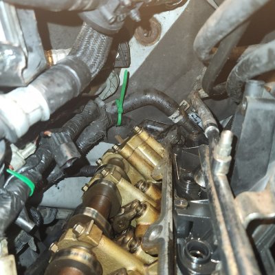

What is the secret to pulling off the passenger side valve cover? It seems to me that the two metal AC lines coming out of the bulkhead won't allow me to lift the cover high enough to clear the camshaft. I've been at it for some time with no luck. Any suggestions?

Did you pop the heater hoses off the firewall ? If you didn't, it will probably take an assistant to pull the hoses out of the way enough to remove the valve cover. You can use Super Glue to hold the new gaskets in place during reassembly. If the intake is off you can roll it that way.

@Eric M its a PIA for sure. You gotta have all the stuff out of the way to get it off. Yeah you can either have someone hold the heater hoses out of the way, or remove them. They are a weak point and will eventually leak and leave you somewhere, so consider replacing while you are at it. For the AC crap in the way, just loosen the accumulator (that small shiny metal device) from the firewall and it will give you enough play in the lines to make it happen. Also, remove the plastic inner fender skirt (bunch of 7mm bolts and a few pushpins) and unbolt the transmission dipstick tube. You cant pull the RH valve cover without unbolting the dipstick tube.

Thanks Hamfisted and Vincent Vega for the input. I actually removed both heater hoses and have all other hoses and wires tucked well out of the way. I was wondering about that tranny dipstick tube. I am going to unbolt it and hopefully I can then shimmy the cover by those AC tubes. The accumulator doesn't seem to be an issue here, just those two metal AC hoses that sit right above the rear of the valve cover.

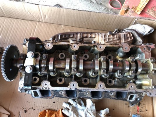

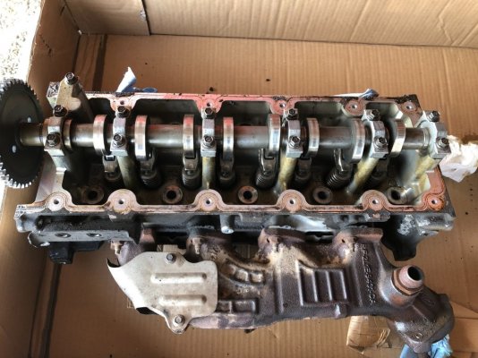

Finally got the heads off. Fortunately for my lower back, they weren't as heavy as I thought they would be.
Driver's side came off no problem.
Passenger side was a bit ugly. I pulled a rookie maneuver and forgot to remove the bolts (fastening the braided ground wire and coolant tube bracket) and Christmas tree attachment behind the passenger side head. This means that I had to abandon the removal two separate times and was unable to cleanly set it back down each time. I managed to slip a tarp underneath when I realized there was a problem.
I did notice some very tiny scratches but nothing too deep in the head mating surface. We'll see if the machinist thinks they are salvageable.
Removing those rusted on manifold nuts and studs should be fun....IMG_1428.jpegIMG_1427.jpegIMG_1429.jpeg

Marvel Mystery Oil and a rag seem to do pretty good cleaning up the carbon from the intake manifold runners. I didn't try it on the heads 'cause I had mine rebuilt anyway and the shop cleaned it all off. Did you say you had a head gasket leak ? I might've missed it.

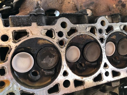

Yes, it was a blown head gasket. After mulling this over, I decided to buy two reconditioned heads from these guys: https://www.cylinder-heads.com/

I don't see many problems that a good cleaning and a little work wouldn't solve. I would work with what you have rather than some shop over the internet. Find a good shop and see if you can get somebody with a good reputation to rebuild them. There are no cam bearings. I would mic out the journals and cam to see if there is any wear. If still good, pitting on the mating surface to the block, dirty oil passages, and cam journal wear are usually the problem areas. As Hamfist suggested, lapping the valves yourself is fairly easy. Rockers arms don't usually go bad, and valve seals are simple.

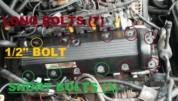

I did mine without removing or loosening my tyranny dipstick...but I did manage to break a bottom bolt installing the valve cover.. I need to find a diagram that shows the location of each bolt..20220903_140159.jpg
Your valve cover is a great diagram for where each bolt goes...
Your Ford dealership still stocks the bolts. p/n XL3Z-6C519-CA = Hex Head Bolt / Grommet combo
W705644-S437 = Stud Bolt
2C2Z-6C518-AA = Sleeved Grommet
