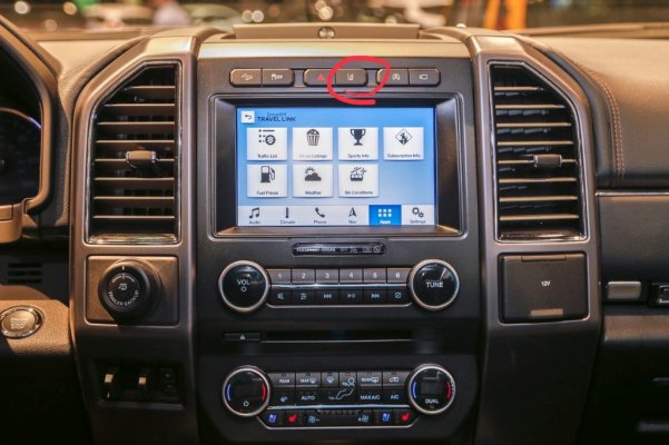

I just purchased cabling and downloaded software for FORscan for my 2018 Expy. Is there a way to default auto start/stop to off with the ability to turn on from the dash board button. So when you turn it on the auto start/stop is lit “OFF” as the default and it I choose to enable it I can simply hit the button to turn it on. Next ignition cycle it defaults back to “OFF”. There are times when it would come in handy but where I live I really don’t need that as a constant on.

I just purchased cabling and downloaded software for FORscan. Is there a way to default auto start/stop to off with the ability to turn on from the dash board button. So when you turn it on the auto start/stop is lit “OFF” as the default and it I choose to enable it I can simply hit the button to turn it on. Next ignition cycle it defaults back to “OFF”. There are times when it would come in handy but where I live I really don’t need that as a constant on.
I had the same question when i started looking into it. The only way to do what you want is to hard wire a switch into the back of the auto stop switch (other forums cover how to short the switch with a little wire.. basically you install a second switch on that wire, which allows you to turn on and off your always off switch. (hope that made sense)
with Forscan, your only option is basically nuke the feature all together. As was explained to me, the value you are toggling is one of many checks that the auto start stop looks at. as the check fails, the engine doesn't stop.
I to would like the option to selectively enable the auto stop (like sitting in drive through lines, etc..), but given the choices, i choose to idle.

That is too bad. I guess switched off it is. Hopefully someone smarter than me can figure it out. I wonder why Ford didn’t give an option to control that feature a little more. I can set up mood,lights but not control engine functions.
