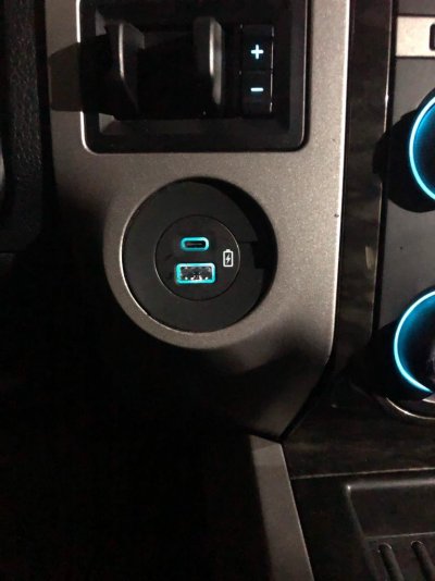

I got this done 2 weeks ago.

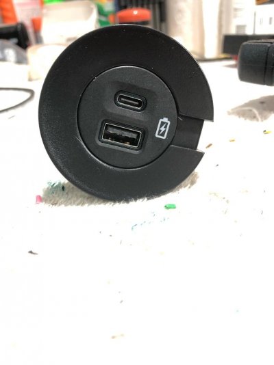

Bought the 12V powerpoint bezel without the cap, The USB-C charger is also an OEM Ford part I bought on eBay.
Required a little bit of ingenuity and jerry-rigging to mount it in place of the coin holder but it didn’t turn out half bad.
Wired it to turn on/off with ignition and backlighting is wired to the instrument panel backlighting circuit ( it dims up and down with the rest etc...)

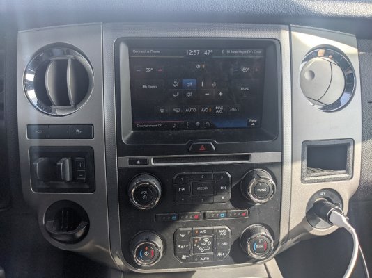

I replaced the coin holder on the side of the radio closer to the driver.

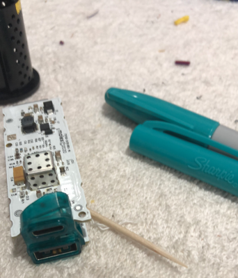

Not sure it's a mod for everyone because it took a lot of tedious fab work to get the USB charger to fit in the 12V bezel. Then to get the 12v bezel mounted in that hole. The backlighting is actually white so I used an aqua marker to color over the LED reflector to match the OEM dash backlighting.

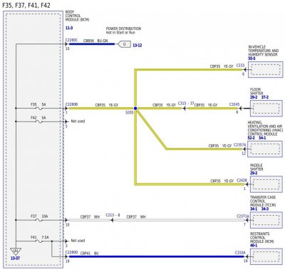

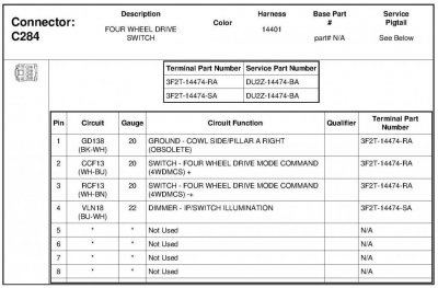

- DU2Z-14474-BA (add terminal in C284 slot 5 for power source)
- DU2Z-14474-AA (add terminal in C2280B slot 5 for power source)

Wiring:

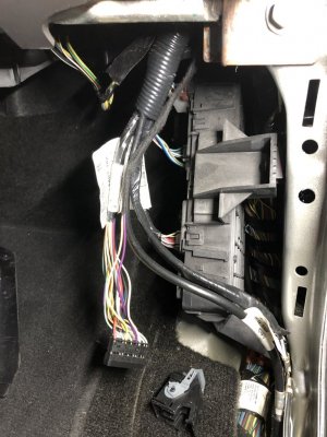

The coin holder has a connector behind it for the 4x4 switch even for the Expys that didn't come with that option. It's an 8-pin connector but only has 4 wires, the other 4 slots are empty. I ran a wire from one of the BCM unused power sources at C2280B pin 5; it already has a pre-existing 5A fuse @ Fuse# 42. Ran that wire to one of the 4 empty slots of the 8-pin connector.
I made my own harness adapter to connect the USB charger to the 4x4 switch connector; so as far as wiring goes, it's a clean plug-n-play install with no splices.
4x4 switch Pinout: (See Thumbnail pics below)
Pin1 - Ground
Pin4 - Inst. Panel backlighting with dim up/dn
Pin5 - (originally empty) Power - from C2280B pin 5

No it doesn't change colors, it stays the same aqua blue color like the rest of the Radio/HVAC panel, the switches throughout the vehicle, shifter letters, etc ... but it dims with the rest of the dash panel the way I have it wired.
