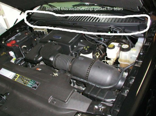

What cylinders are you usually finding water in their plug wells ? If it's the very rear cylinders make sure your hood cowl weatherstrip is still there and water isn't running off the windshield cowl and onto the top of the motor. Are your front wheelwell liners gone ? And no, you can not drill any holes in the sparkplug wells.
There aren't any tears on that gasket although I thought of that. I could add some soft weatherstripping to the underside of the hood.
Cylinders 1, 2, 5, & 6 are the ones that get it the worst.
