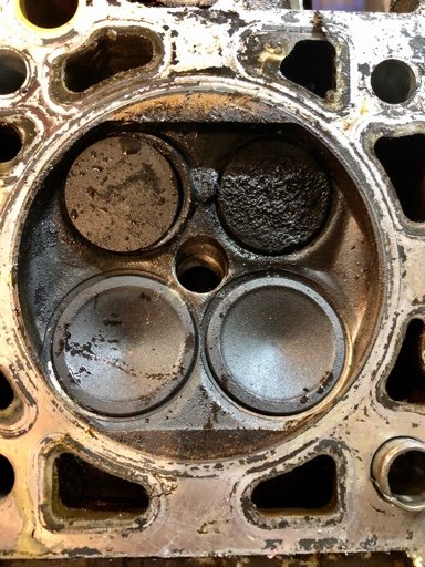

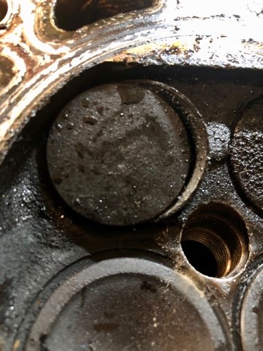

Looks like the exhaust seat popped out. Only viewing on a small phone screen here and there could be some little indentations in it from something being in there bouncing around I'm not sure. And can't tell if there's any burn damage around the aluminum. I'm sure it can be fixed but sometimes it's cheaper just to get a used head and bolt it on.
This happens on lawn mowers all the time but I didn't think it happened on cars anymore. The biggest problem you hear of with car valve train would be a spring breaking or maybe a vowel dropping in which causes all sorts of damage but is not from a seat popping out. To the best of my knowledge the only reason I see it pops out is because it gets overheated in that area and the aluminum expands and let it pop out. But I only deal with aircooled engines on these kind of things.
If it were on a mower I would remove the valve and press the seat back into the proper position as best I could and stake it all the way around to hold it in placeand then make sure the valve sealproperly and maybe even lap it with valve grinding compound.
But I wouldn't wish this on a car because it is far too hard to remove the head asyou know all too well.
He want to make sure whatever you put back on is in perfect operating conditionand going to last a while. Because you certainly don't want to have to do it again.

I dropped the head at the machine shop tonight. He didn’t see anything that looked concerning except the one valve. He said he’d have a closer look tomorrow and let me know what parts we will need. He even said if I needed help when getting the timing components back together, he and his son would come over and help me. I know he would as he has dropped everything before when my powerstroke left me and the ex couldn’t figure out what was wrong with it. Maybe I’ll get this thing up and running after all!!

Woohoo-my machinist just called me with great news. He said the valve looks totally fine and it just popped out of the seat. He is going to clean everything up and pean the seat so it won’t happen again. He said I should buy a lottery ticket today!!

Well, that's what you do with lawn mowers but I didn't know they did that on auto heads. As long as this is an actual machine shop and they know what they're doing you should be good to go. When I do on a mower always check them to make sure they seal properly but they often do go right back into place just perfectly. Sometimes I even lap them to help seal.
