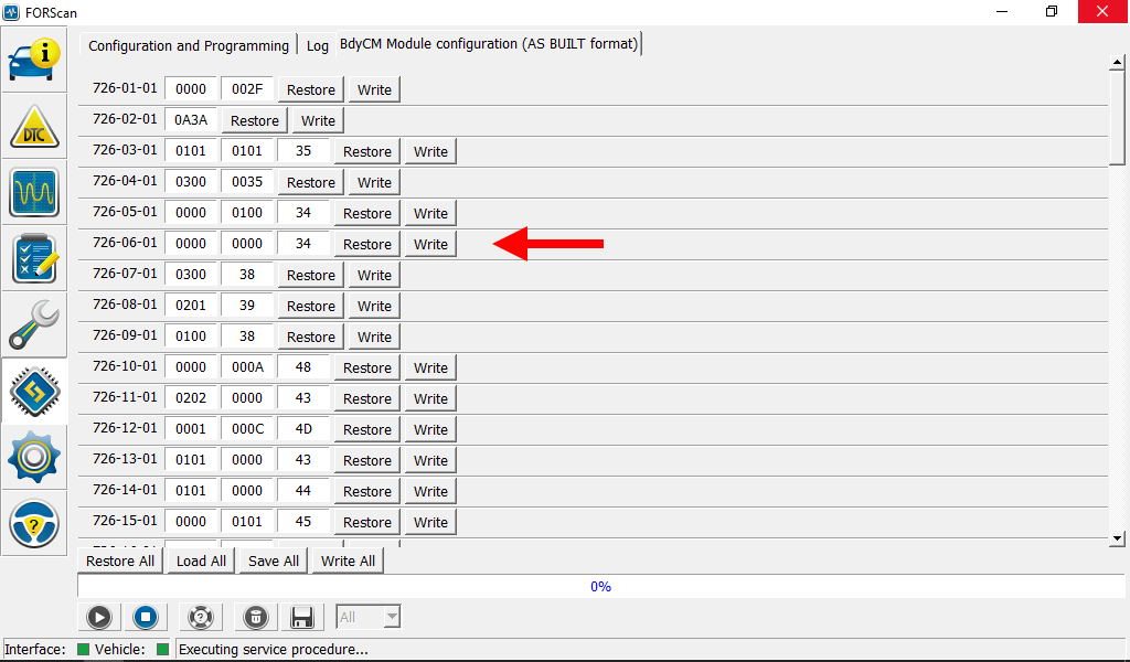

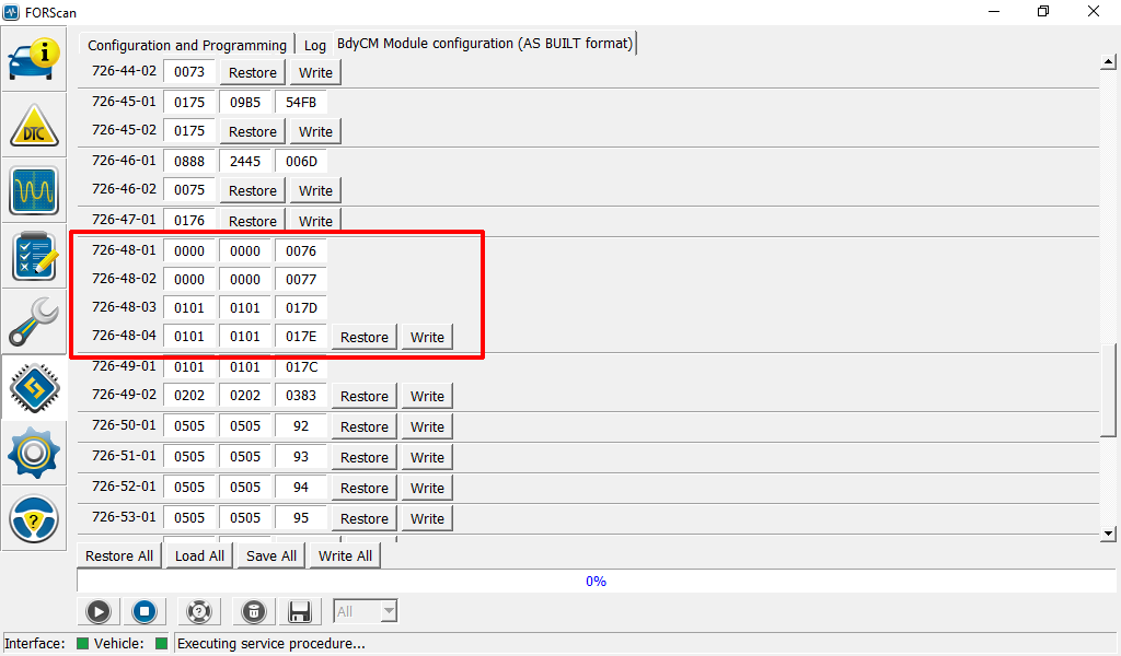

On a 2017 rig has anyone experimented with 726-06-01?
Or 726-48-01?
mossback
2017 Limited EL
Oct 9, 2017
359
176
WA state
I'm not sure what it affects but my hope is that these could possibly be secure idle related based on the field data from other Ford vehicles. Purely a guess based on what's known to this point. Curious if anyone has already been down this path. If not I'll do some more trial and error testing.

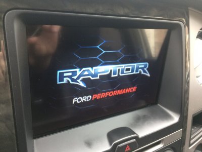

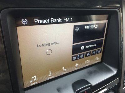

Here is the way to modify your Sync 3 startup screen:
APIM 7D0-02-01 xxxx xXxx xxxx change X to:
1/2 - Standard
3 - LINCOLN Black Label
4 - LINCOLN Presidential
5 - Raptor
6 - Mustang
7 - GT350
8 - Vignale
9 - GT350
A - Standard
B - ST
C - RS
D - GT
E - Continental
F - Standard
East-TN
Air Force
Jan 4, 2018
533
269
TN

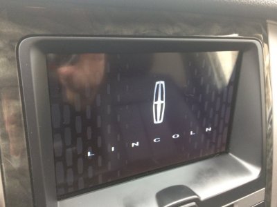

You can also change the Sync 3 Theme (background) to the brown LINCOLN design by changing both APIM lines as follows:
APIM 7D0-01-02 8xxx xxxx xxxx
APIM 7D0-03-01 xxxx x2xx xxxx
This will also give you the ‘LINCOLN’ power down screen (no change to power on screen)

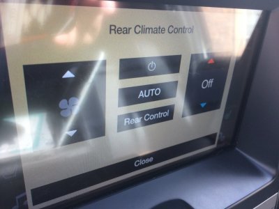

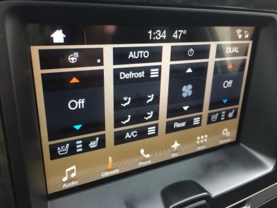

528273D8-47B9-4DE9-B6FB-05DA25350E46.jpeg No luck.
I can get Auto to display on the rear control (see pic), but I can’t get the rear to follow the front Auto setting.
I tried various combinations of modifying the following 2 lines...separately and together:
APIM 7D0-01-02 xxxx xxxx 0xxx
changed the 0 to everything from 1 to F and got various combinations of Auto/No Auto/No rear temp control on Sync 3 screen for the Rear control setting
HVAC 733-01-02 xx0xx xxxx xx
changed the 0 to 4 (automatic) and I could hear some click noise in right rear of Expy like some setting had been changed, but didn’t notice any changes to controlling the rear air
Anyone else investigating this feature?

Is it possible that using AUTO mode for the rear is designed to disable the rear controls in a vehicle that’s programmed that way originally but it’s not doing that in yours?
Maybe try either disabling rear control through the HVAC or setting it to front control only by changing 733-01-01 to x0xx xxxx xx (disabled) or x1xx xxxx xx (front control only); and see if that makes a difference?
I have MFT, which doesn’t mention the possibility of auto in the rear at all, so I don’t think it will work in mine.
I thought about using the Police Mode you suggest, but I didn’t want to take manual control away from the passengers in the back...but maybe I should try it to see what effect it has on the other HVAC settings.

View attachment 23486 No luck.
When it shows that rear auto screen, does it actually show a numerical temperature setting like it does for the front climate control? Right now I just have high and low and anything in between. I haven't looked on the rear control panel to see if there is an auto setting.
