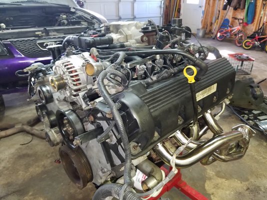

With the right system, the 4.6L sounds great. I helped my son put headers on his GT when we rebuilt the engine. It depends on you whether the juice is worth the squeeze. With new fastener options like Stage8 header bolts and better sealing gaskets, the leaks of yesterday can be eliminated.
My guess is that, unlike with the GT, fitment won't be an issue with the size of the engine bay.
See the header bolts in this pic. No leaks after about 5k miles.
34655932640_c5196a8f45_z.jpg[/url

I would go with long tube headers for starters. That's where you're going to get the benefits. A quick google search for Stage 8 will give you a million different vendors. Summit Racing being one of them. Amazon? etc. Percy's sells aluminum gaskets that work well. There are a million different options. These are just a few that have worked in the past for me.
Cabin noise. That I can't really comment on because I haven't driven in Ex with headers. Generally speaking you're going to get some, but if it's a good install, it should be coming out the tail pipes and not from any echo in the engine bay.
