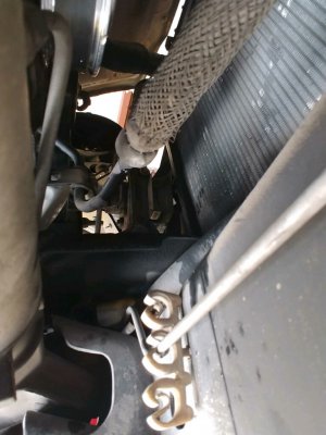

Yes I have an aftermarket radiator. But my fans have been mounted on an all aluminum radiator as well as a OE replacement.
I’d be curious to see pics of your radiator.

Taken from under vehicle; not the best but you can figure it out.

Interesting. The transmission hard lines look legit but that hose clamp does not look like a typical factory clamp.
I’m confused. Someone put in a bunch of effort to make a different radiator work.

Tom, I am also confused as is my tech. The fitment and connection issues with the Gibson headers that Gibson has never seen before and the not fitment of a "direct fit" Flex A Lite fan kit have us scratching our heads.
I am pretty dang sure that the radiator was installed at the factory. I purchased the vehicle in late '03 with less than 4K miles logged. The vehicle had been driven for a few months by the dealership sales managers wife and she fount it too big and cumbersome to her liking so the put it on display for sale out in front of the dealership. At the time, I was driving a two year old Explorer that needed some work and when I took the Explorer in for the work, I saw the Expy, we made deal and I bought it.
The Expy was badged as a "Touring Edition" which, to me and at the time meant nothing more than some trim differences. A small Touring Edition badge on the lower left corner of the tail gate and Touring Edition embossed on the driver and passenger seat just below the head rest. I have never seen another like it. We have run the VIN and nothing strange shows up. However, I am now wondering if it is a bit of a bastard Expy since we are having issues that have not been heretofore encountered on an XLT.

Radiator mystery solved. Apparently radiators in the '03-'04 Epxys were down flow units with top/bottom tanks which was a mistake. The trucks ran hot and in '05 the Expy radiators reverted back to cross flow units. We got the FF Dynamics fans installed without any major issues. The fans are nice; good hardware but the wiring turned into a semi DIY project; not plug and play like other kits. At any rate, they are installed, do the job and are very quiet, much more so than the fans in my wife's '15 Explorer Sport. On balance, a satisfying upgrade.
