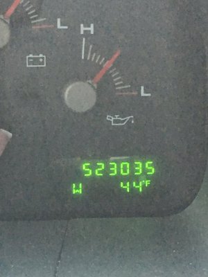

Last I saw it (daughter drives it) there were 305-306k miles on it.
