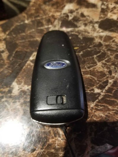

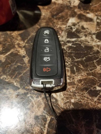

Thx, I received my keys today. I'm going to try and get them cut tomorrow, and then mess with programming followed by FORSCAN enable remote start option.0f6644ff5a1fb9bcf0b038e56830a504.jpg
