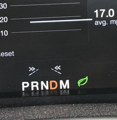

Hi all, hoping for some help here. I had my sunshade replaced under warranty where they had to pull off the whole headliner, from to back. I got the car back and have been getting this warning. Front Camera Low Visibility Clean Screen". I soon discovered this was the camera on the winshield relaying info for the Lane Departure as my lane departure has not lit up green since bringing the car in. It is activated but not working.
I brought it back in to the dealer. Told them exactly what is going on and the fools came back saying my windshield was dirty and they cleaned it and didn't see any errors. I told them I did that previously and it's a bigger issue and asked if they test drove it to confirm it works and they claimed yes. I got the car back, no added miles, still doesn't work. Needless to say it's going back to them tomorrow but does anyone know what the next steps are? These guys seem to not have the slightest clue. They put on the summary that next steps would be to replace the front windshield and recalibrate. When I called back the service advisor said "well, we'll try and fix it not sure what's going on". Not exactly what a customer wants to hear. Just tell me you'll fix it. Seems that it's more of a camera issue and not windshield issue. New camera needed?
What can I do to speed this process up and not just replace a windshield and calibrate and NOT have that be the solution?

Are you still getting the error message?
There are two places to enable it. The instrument cluster settings and the button over the center screen. Does your screen look like the picture below?41704F5A-06F7-4A1D-834A-FD5299A4CCD7.jpeg

Yup, my lane departure lights up but will never initiate / turn green even when on the correct roads. Fairly confident they either dirtied up the camera behind the glass when they removed my whole headliner or they somehow broke the camera or dislodged it all together during that process and it thinks it's dirty as a result. Unless anyone has has any input?
Would love to be able to tell these people exactly what I need done as they seem pretty clueless and just do the bare minimum and hand the car back to me without fixing the problems.
