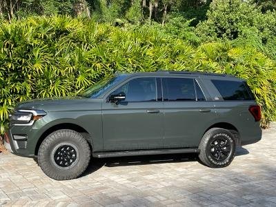

Trying to decide between 295/70/18 and 35/12.5/18 on my Timberline. Front end is definitely lifted compared to other 22's I compared on the dealer lot. I've been really busy but going to mount my 35/12.50/17's from my Raptor as a test fit. Definitely need more tire width for FL sand. Looking at suspension options.

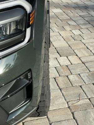

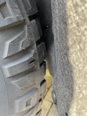

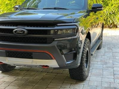

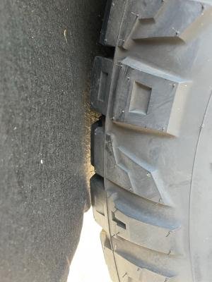

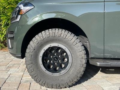

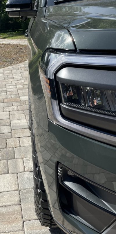

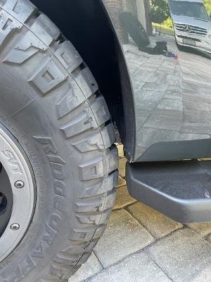

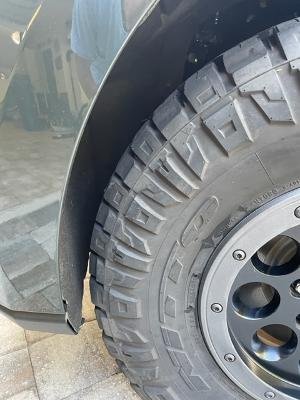

So I mounted one of my 35x12.5x17 Nitto Ridge Grapplers on the Timberline. I think the wheels are 17x8.5 34mm . Actually was surprised there was as much clearance. If I was going to run that combo I would pull back the fender liners. I think I just decided I'm going to run a 295 rather than the 35's.
Thanks for the update. I can't wait to get my old wheels and try them on. Granted, I only have 3 good ones. I will need to buy a 4th wheel and tire.

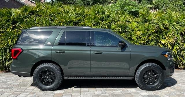

Here's a few more:
Thanks.
My current inexpesive thought is to just go the 2 or 3 inch spacer route for now (suspension spacer not wheel spacer). Since it is already leveled, the 3/2 ReadyLift won't work right.
I'l have to buy 1 wheel and probably two tires (at a minimum) in order to get the old wheels road worthy.
Then, I will have it back to the way it sort of was with my 2019.

Coop7379
Feb 16, 2022
13
Jacksonville fl
Rough Country 3inch Kit
295/70/r18 (34.5”) Cooper Discoverer AT3 XLT
Pro Comp 40 Series Vertigo Wheels
Relocated Fender Liner
16.5 inches of clearance at running boards behind front tires. 17.5 inches of clearance at running boards I front of rear wheels.
No rub whatsoever with this setup!
this set up looks great, I am waiting for my rough country kit to arrive in the mail. now I know what tire size, the question will be am I going to need to put wheel spacers on it because I plan to run the factory fx4 tires.
