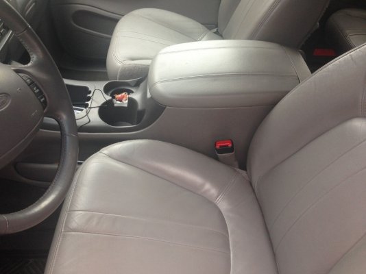

The interior is rather disgusting but 15 years and 174k miles and the drivers seat is not ripped. That is rare:

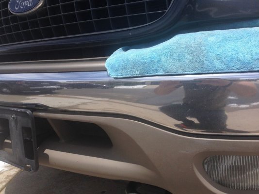

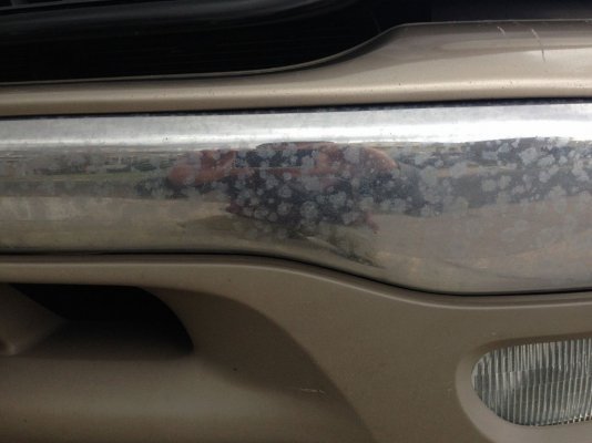

The bumper chrome looks bad vim not big into chrome so I'm not sure what I'll do here:

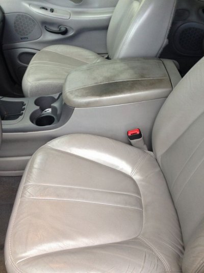

I've started going over the interior with a Magic Eraser. The center console is not black anymore. The seats are coming along. I had to cut it short because it started raining/sleeting/snowing. Tomorrow will be full of cleaning the interior and adding some leather conditioner to the seats.

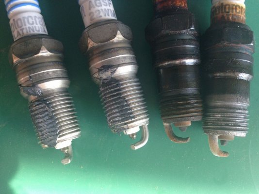

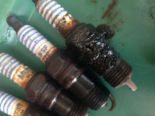

Changed the spark plugs, one coil, and all of the coil boots today.
I'm pretty sure these plugs were the original. They were all worn to about 0.068". The new plugs were gapped to 0.054". I'm pretty sure I've got a valve cover leak on both sides near the firewall. Those plug wells had some oil down around the nut.
Here's the old plugs:
The new plugs are threaded higher. I guess this is to address the plug blowout issue.
The #6 coil had a crack in it so I put in a new Motorcraft coil. Seems to run nice and smooth now.

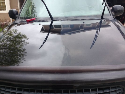

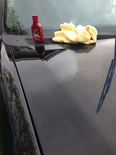

It's been raining here in CO for about a week and a half. Suppose to snow tonight as well. To confuse the weather gods I went and applied a coat of RainX to the windshield. That's a sure way to make it stop raining. But then I waxed the hood- which as we all know is a sure way for it to rain. So watch the news to hear about the strange weather phenomenon in CO- that was me.
Possibly the first time this truck has been waxed:
