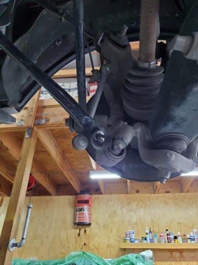

Ok, so having my rear sway done today along with rear Bilstein 5100 and front Bilstein 6112 and UCA.
The guy doing it for me sent me this. Damn sway bar link undone.
Anyone else have this issue? Anyone doing the rear sway replace the swing links?

The failure mode looks like it was twisted off. Did they use an impact on it? The service manual is very specific that impact wrenches should not be used on several of the ball joints up front including the sway bar.
That is the factory installed, we had not touched it at all.

I’m having some new rear sway links overnighted from Rock Auto.

If the two pieces have been rubbing together for that long it should be obvious with missing paint on the bar and the link. If not my guess would be the impact is the culprit. If so you should drive it around with the factory bar hooked up. One side off is basically like not having the bar on.

Yeah.. not doing that one. I ordered some rear links off Rock Auto, they got here yesterday just in time slapped them on.. 10x better than OEM.
So got rear sway on, new Icon UCA and Bilstein 6112 up front and 5100 in the rear. Damn! Drive and rides so damn much better..
May need to raise the 6112 a bit more to raise and level it out a bit more.. seems to sit lower.. but overall pleased with the set up.
