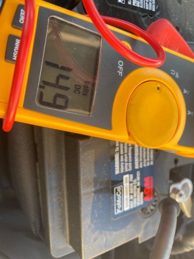

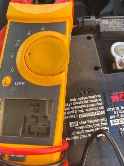

This 1000 mile round trip I just took to Ohio and back should have topped it off, if that didn’t do it nothing will.

That’s, very interesting. Are you still having ASS and light, controls issues? If not, maybe the 12.3-12.2 is all we can push into the stock battery with the stock system. Last week it took my Optima charger (I have the big one) 8 hours to go from 30% to 100%. I didn’t even think to check the voltage. All my door lock and light problems go away after a good charge. I have only charged it twice in a year.

I always turn the ASS off and I use the small version of that Optima charger. The only reason I checked the voltage is because I had ran a plug for my trailer and I was checking polarity and that’s when I noticed it was 12.2. This was the day after a 500 mile drive.
