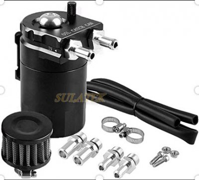

what about "Oil Catch Can" ?
sulatek
Sep 3, 2019
77
ME
Welcome everyone
I have a few questions
-Who among you knows about this tool?
-Is it effective or is it just a waste of money?
- If it is effective, and at this price ..
then, why do not companies add it to cars by default as an important piece?
We always find the wonder of car manufacturers,
they are slow in adding such parts that serve vehicles
I thank everyone who has answered me in advance

2011-2014 EcoBoost motors had a bigger problem with the intake valve coking. Starting in 2015 Ford redesigned the Ecoboost and added a second port injector to compliment the direct injection system, to help wash the backside of the intake valves. It won't hurt anything to add a catch can to your 2015 Expy, it may prove to help collect a little oil residue before it gets recycled into your intake system, and give you peace of mind. But your 2015 intake valves are getting washed anyway, so you probably won't notice much benefit to your intake valves. Not like the 2011-2014 motors would see.

If you buy a new car, yes. An older vehicle that has never had one, there's kind of no point. I put one on my 2016 Challenger a month after I bought it new. I have emptied it a few times in 20k miles, which means it really is catching oil instead of letting it go back into the engine to be burned (ie turned into carbon deposits).

Actually the gen 2 ecoboost didn't make it into the expedition until 2018. So yes, adding a catch can to a 2015 would be a very good idea.

You are correct ! I looked into the year of implementation and it was '17 for the F150 and '18 for the Expy/Navs. So the catch cans will benefit the Gen1 Ecoboosters including the '15-'17s. Thanks !

They do what they claim to do (catch oil), but there is no evidence at all that engine life is extended.

I added one on my Gen4. The maintenance is easy, and their are little know negative side effects (At least I have never heard of any). I also think it will help clear up things over time, especially if you run additional fuel cleaners (which I think may dilute oil, so you may have to change a bit more frequently) and injector sprays (professional mech level).
