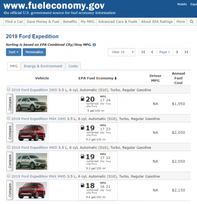

Yes … bit of a different subject but related. All the government MPG fuel economy (not HP) testing is done with "premium fuel" .. so if you use regular fuel for your day to day driving you will always achieve less MPG (in a vehicle that can take advantage of premium fuel).
:emotions33:
Plati
May 4, 2016
2,781
1,367
Interesting, but I'm not sure what that means.
Various interpretations possible I guess.
I do see the Regular Gasoline
You know (I'm sure everyone does) you can't believe everything you read.
Anything I post is in that category too!! I try to be accurate.
Here is where I got my info.
http://www.automobilemag.com/news/octane-fuel-economy-horsepower-epa/
and its says:
"The EPA and automakers use Indolene test fuel for all (gasoline) vehicle testing, for consistency purposes," a spokesperson for the agency says. "Indolene is a high-octane fuel that meets a wide range of technical specifications."
another interesting factoid for the testing is that they dont actually measure the volume of gas consumed. they collect the tailpipe exhaust gas and measure the carbon content and calculate the amount of fuel they "figure" was used (amount of energy). maybe they added a fudge factor and calculated it to what was used if it was regular vs premium? so they might fill tank with Indolene but calculate MPG out to be representative of regular octane. i think they also add a fudge factor for the aerondynamics and rolling resistance of the vehicle. the testing was designed by F'in Engineers after all.
