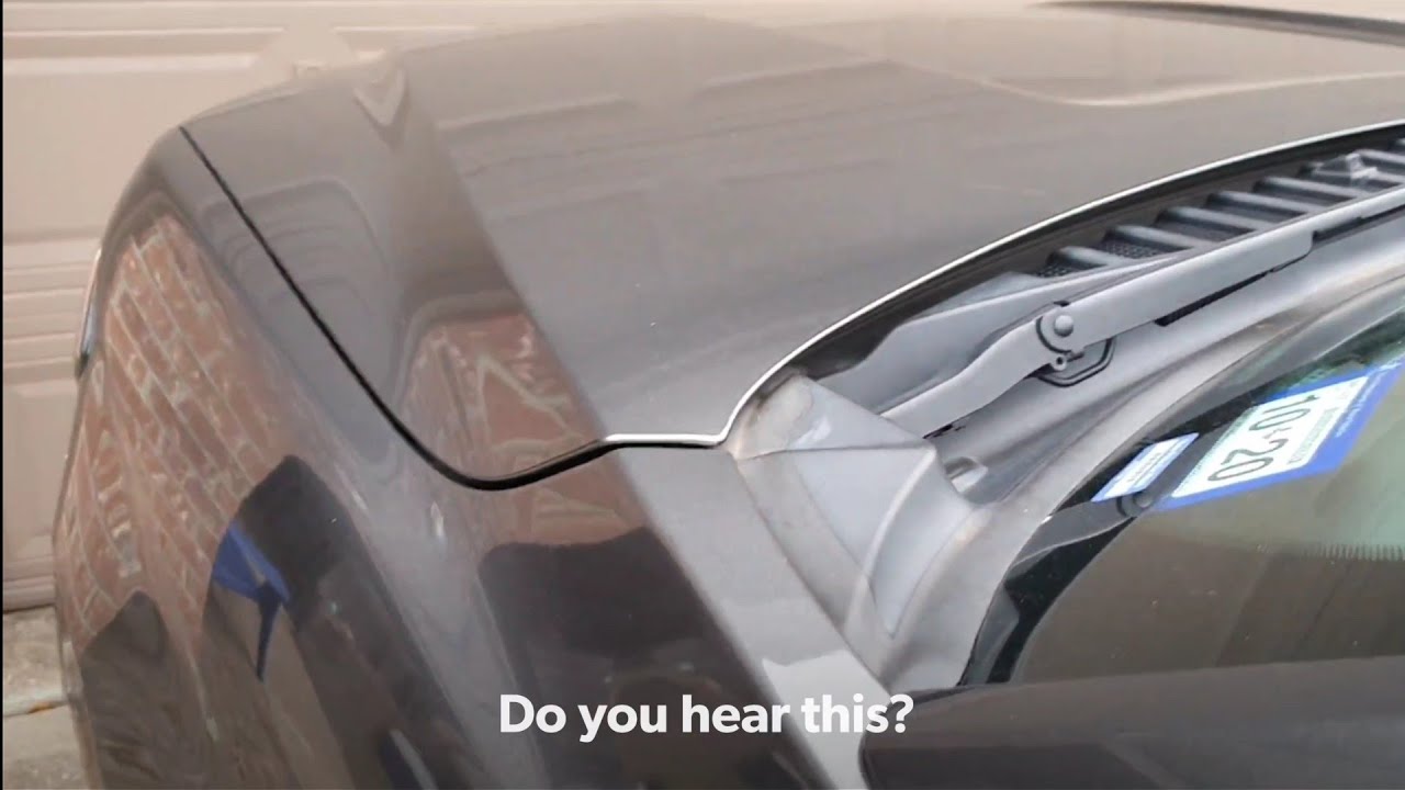

check this video out. Guy added a pre-oiler to his 3.5L. problem solved with phasers.
