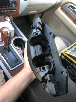

Haven’t most manufacturers moved to 4 pistons on the front with bigger pads for 1/2 tons in the last 2 decades? My passenger side front seized up so this morning I hunted down one I could find in stock today at NAPA....no dealers locally had stock. Doesn’t seem like much brake for the weight they have to stop. Seems to be well built and good corrosion protection but it seems the OE overall design could have been heavier duty.

I wonder what the benefit of 2 pistons would be, from an Engineering basis? The hydraulic pressure from the brake line doesn't change so that pressure would simply be split between 2 calipers vs one … resulting in the exact same force on the brake pad? New caliper has double the number of pistons so doubled probability of failure. No longer centered piston so if one is weaker you have unbalanced pad pressure, would not be best. What is the benefit? Do you still use the same pads?
not a slam, a fair question, kind of Negative Nancy I guess but interested
This is an OE style from NAPA, the stock calipers on my ‘07 are 2 piston same style as pictured on the new unit.

I'm surprised to hear someone say the Ford brakes are wimpy. I don't think anyone has gone to four piston calipers on regular builds, but I could be wrong. That's more of a performance thing. If you've ever had to panic stop with a 3rd gen Expy towing a 10k lb trailer, as long as the brakes are in proper working order, I don't think you'd say they're wimpy. I've found them to be plenty beefy.

Toyota uses a 4 piston setup on many from what I’ve read in the past. Here is a set of Tundra calipers. They look a lot more up to the task than ours:

I was a few car lengths back, that doesn’t do much on a state road going 55 MPH when a drunk driver slams on the brakes and decelerates to 0 on a dime. My truck went into a skid and had zero braking power so it’s not the brakes fault in that instance. No reason to be rude though.
It seems piston #s don’t matter, since the tundra scored terribly on the results you posted.
