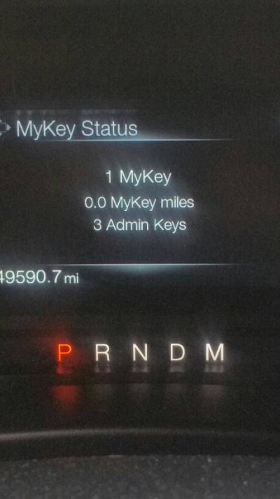

I haven't seen anything on low fuel warning. Is there a way to change the alert to come on, say at 1/4 tank. That way maybe my wife won't park it on empty! Lol
Sent from my SAMSUNG-SM-G870A using Tapatalk
I found out if the my key option is used, it will give a earlier low fuel warning than normal. Now I just have to trick the wife into using the restricted key.
Thanks @mquick5 - I think I need to go do some reading and learn about mykey and restricted key. I read your post at first and thought I would need to use some kind of valet key or something, but maybe this is something that's programmable in my key. Not looking to add any restrictions to my vehicle use ;-)
It should all be explained in your owners manual. You can set stuff like speed limit radio volume, but can also just leave them off. I don't know how much earlier the fuel warning will kick in, the manual just says that it does. And the my key is just programed from the dash.
Currently the wife is using the my key fob. Once she gets the low fuel warning, I'll report the dte. I turned everything off in the dash control. She informed me that the radio will not play until your seat belt is fastened. Not sure about passenger buckling up. I do know my truck never alerted about passenger belt, with the regular key. And I never changed this in forscan. I also know my uncles 2017 F150's radio won't play until both front passengers are buckled. So I wonder if he is using a my key fob?

My key update:
The low fuel warning came on for my wife today, reporting 52 miles till empty. So it seams the low fuel warning is aproximitly 20 miles earlier.
