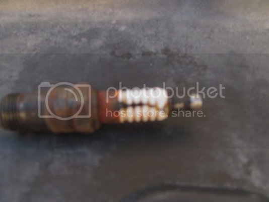

anyway I pulled spark plug 3 first to check it and there was a half inch wide carbon track down the side of the ceramic insulator pulled 4 and same thing so I believe I have found the problem.

P.S. been meaning to post up some pics of my expy here you go, check out that carbon track!!!!

Cool.... bet your happy you found the problem!
Looks like plug hole had water in it at some point with all that rust.
