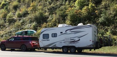

Pulled my camping trailer for the first time this weekend. It has all terrain trailer tires and weighs around 2,000 lbs. I was very pleased with the trucks ability to tow it at 75 mph with very little effort. I'm interested to see how it handles the drag from a couple of kayaks on the roof while towing the camper. My Armada was a great tow vehicle but put anything on the roof and it sucked.
I think you’ll be pleasantly surprised...
