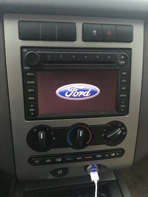

I do like that it reminds me it’s a Ford when I start up now ;). Now time to clean it up, the buttons weren’t the cleanest. Overall the project is easy (10-15 minutes) and after driving around with it for 24 hours I’m happy with the purchase. If you do it just make sure you source it from a similar truck (same year etc.).

Finally installed the GPS antenna today along with the navigation update. Works great.
