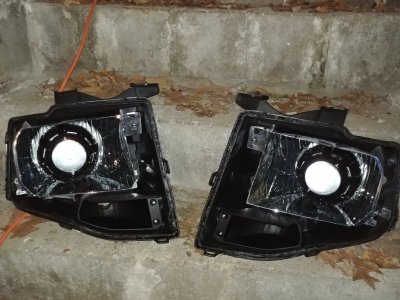

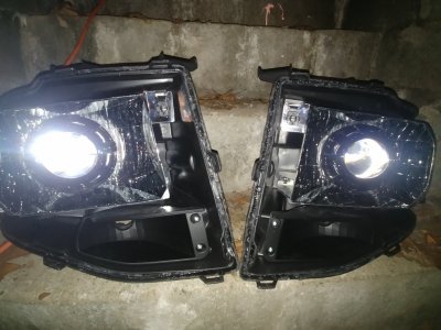

Both projectors are fully recessed and solenoid is through. Time to clean up the holes, set permanent alignment on the car and JB weld the gaps/mounting hardware.
