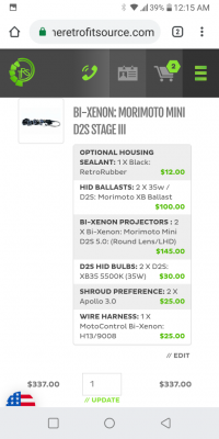

I was thinking any projector with a threaded shaft. The Morimoto D2s 5.0 just came out and performs very close to the RX350. The threaded shaft is what makes a build simple so offering anything with custom mounting just won't happen. I just don't have the time for that. With a threaded shaft build I can turn them around in a few days depending on paint.
Oh yeah, that makes sense. Is the D2s the most affordable projector w/ threaded shaft then?

No, the mini H1 is but the output isn't as good as the D2s. I believe there is only a $30 price difference between the 2
Here's a few pricing pictures. If I do start doing this ive already been offered wholesale pricing but this is just off the site to show the price comparison. They do offer cheaper projectors but I personally wouldn't run them so I wouldn't offer them.
These include evenrything needed (except lenses) and All are quality parts.
