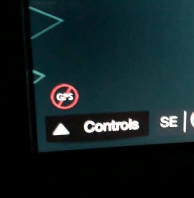

I still have CarPlay issues. About once every 10 times I plug in my phone, CarPlay refuses to start, my phone cycles charging and not charging, and then when I give up and unplug my phone my Sync Nav says it doesn't have GPS. It's weird and switching USB outlets doesn't help.
It's annoying but I've learned to live with it.
Not sure if it's an issue with Sync or just a CarPlay integration issue.

Yep, that's the same situation I have. To get it to correct, you have to shut down, get out, lock the door, wait for the vehicle to completely turn off (dome lights off), then get back in and fire it up again. At least that's what I have to do.
Instead of doing all that, when the problem does occur, I go into the Sync settings and turn off CarPlay. That will stop the power cycling issue and my phone will charge as normal for the duration of the ride.
BUT, if I then use the Sync Nav (because CarPlay is now off) the "no GPS" icon shows up on the Nav map. So whatever the glitch is, it disables the in-car GPS for the duration of the ride.
My suspicion is (although some on here have called BS) is that when CarPlay is on, the truck disables the on-board GPS and CarPlay uses the phone's GPS instead. So when the truck tries to hook up to CarPlay, fails, and I manually disable CarPlay, the truck never turns the on-board GPS back on because it still thinks CarPlay is running. Or something. But whatever it is, when CarPlay fails to start and has to be shut down, the truck's GPS doesn't work.
I have not tried to manually shut down CarPlay when it's working to see if the on-board GPS then works or if the case is that once the truck hands off navigation duties to CarPlay (either successfully or unsuccessfully) the on-board GPS is disabled for the duration.
Who knows.
