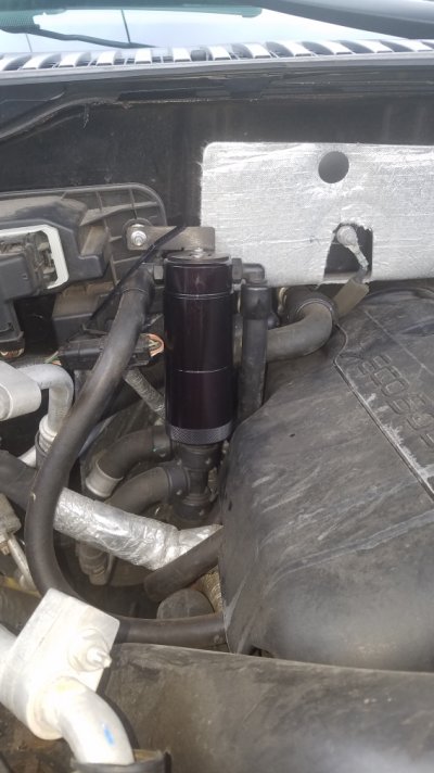

I’ll stop by their shop. I live 20 minutes from em. Will update on ftmentMine in on the firewall using the existing bolt there. I agree it "should" fit but JLT would not say so when I specifically asked. I'll dive in if the First Penguin survives.
-- Chuck
Its tight but fits with no clearance issue. Jlt included a can koozie and decal at no charge!Mine in on the firewall using the existing bolt there. I agree it "should" fit but JLT would not say so when I specifically asked. I'll dive in if the First Penguin survives.

Probably bc of location, would be difficult to get something back in that corner to catch what the plug drains out without having to run some hose way down low to access under the truck, then that hose gets gunked up. Now the higher $ ones that mount to the front of the radiator a little different story. I think for our 3rd gens the 3oz is perfect if emptied 2x between oil changes. At least it is for me. You just need to be very mindful of when the last drain occurred as Ive seen several f150s messed up due to overflowing cans. Also, don’t forget to clean the filter in the top part of the can lid every 10k milesI wonder why they dont add a drain valve on these? Seams it would be just as easy to R&D that, as it did the can extension! Perhaps I will reach out to them and recommend that to them. It wouldn't take much if you had a tap. Certainly would cost less than the $39, for a petcock style drain valve.
I’ll see if I can screen shot the posts from the FB page. Basically it causes a lot of misfires and engine runs really roughYou got a link to messed up f150 threads? I have unscrewed mine to find it full a few times and worried about what would happen if not emptied in time.
It's in all the instruction manuals. I think for the 15-17 expys it says every 15k. I'm just not sure if you have to remove the whole setup, or if you can unthread the 2 hoses?Got it, I also had not read you should clean the filter on the can before so thanks for that!
Correct the entire assembly comes out, hoses and canI read that as "remove the entire assembly, not just the reservoir." Putting this on my annual PMCS.
