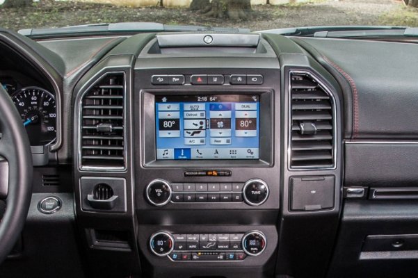

On the '18 Limited there is a deactivation button above the sync screen. Wonder why you would need to leave it activated during engine break-in? I turn mine off every time I get in it.
